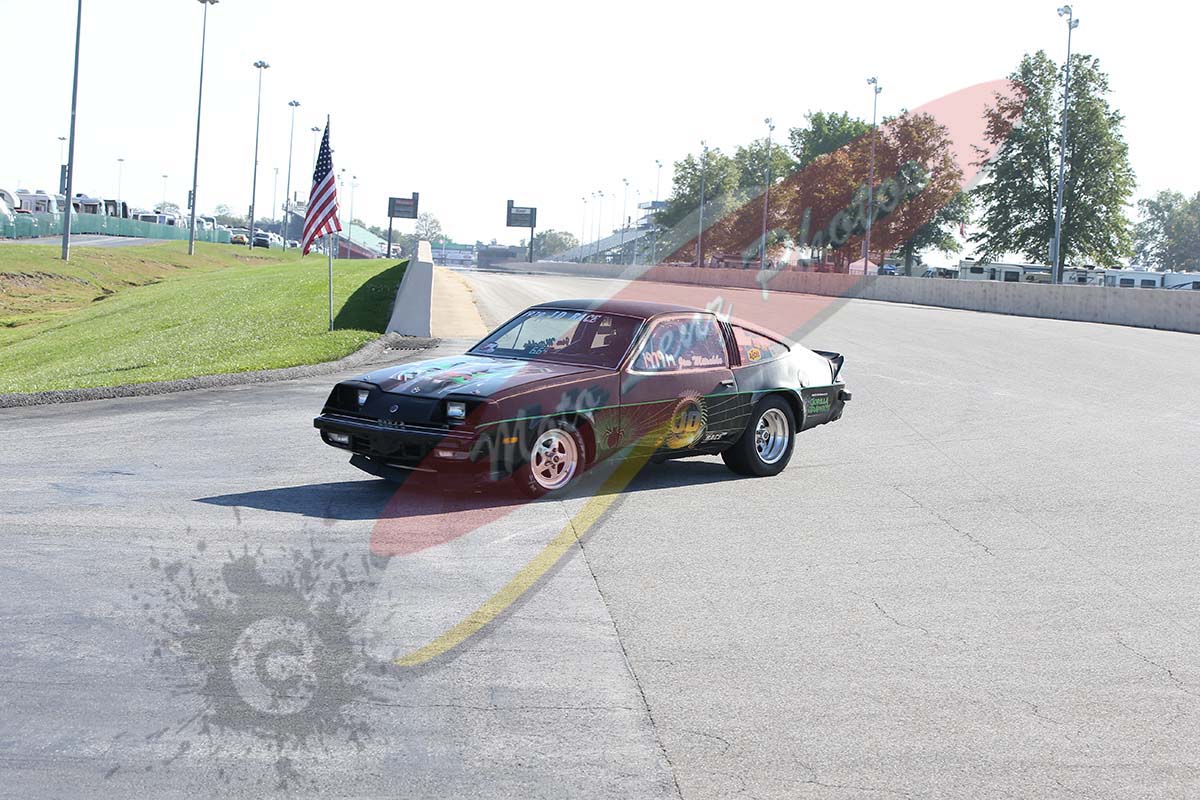

Daughters street monza launching at the track with street tires and 2.56 gears boat motor 350 V8 from summit budget table long block...lol 14.50... she loves bracket racing it...she kills the lights with it and it makes most made because it is slow and consistent....XD
Both daughters were Jr Dragsters for Years... so they eat the lights up.
Daughters Chassis old school bracket car 9.60 at 3/4 throttle 140 mph Will see when she can go full throttle.... no rush there.
she is 20 years old.
My Race car - 9.95 136mph 1/4 mile 1.300 60 foot which was my daily driver years ago turned into race car after it started to deteriorate on the lower rear suspension. 8 point cage so I am at my limit....
NONE of these cars are cream puffs...But we like them a lot they are fun and get the job done.
