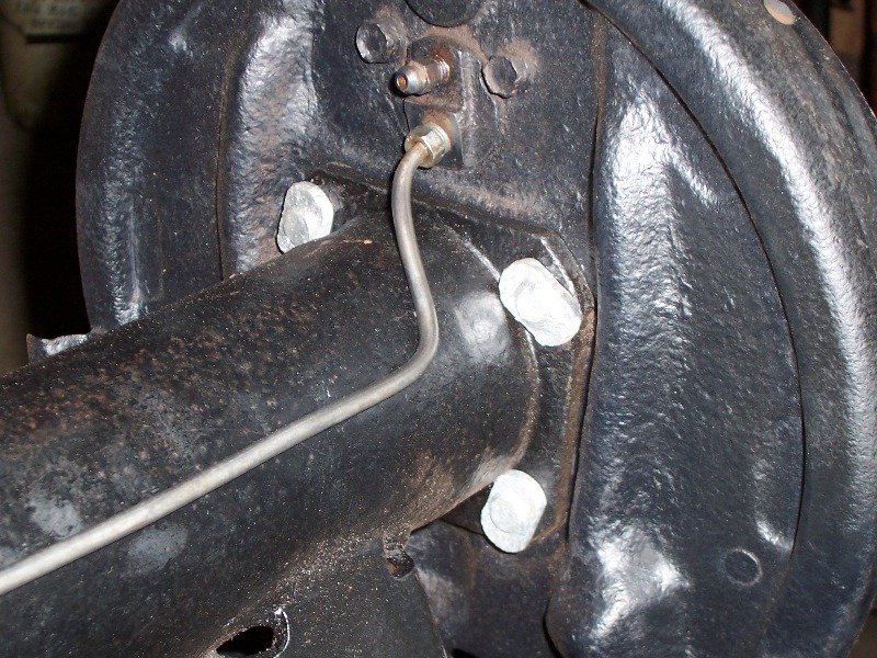

| Axle Spline | 28 bolt in axle 60 degree spline |

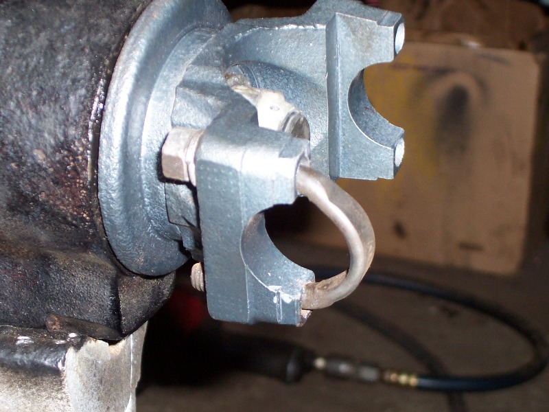

| Yoke style | U bolt & nut Universal joint retention (reference picture) |
