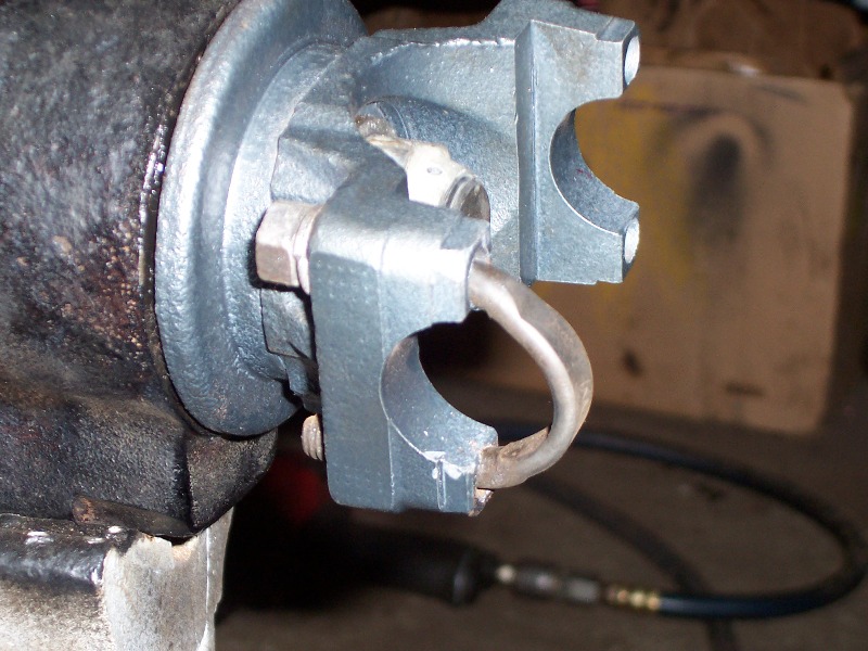

| Yoke style | U bolt & nut Universal joint retention (reference picture) |
