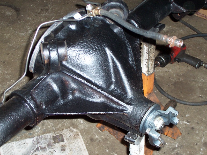

| Ring Gear Diameter | 8.2 B.O.P. Buick Olds
(single lower webbing) Pontiac (diagonal upper webbing and lower webbing) |

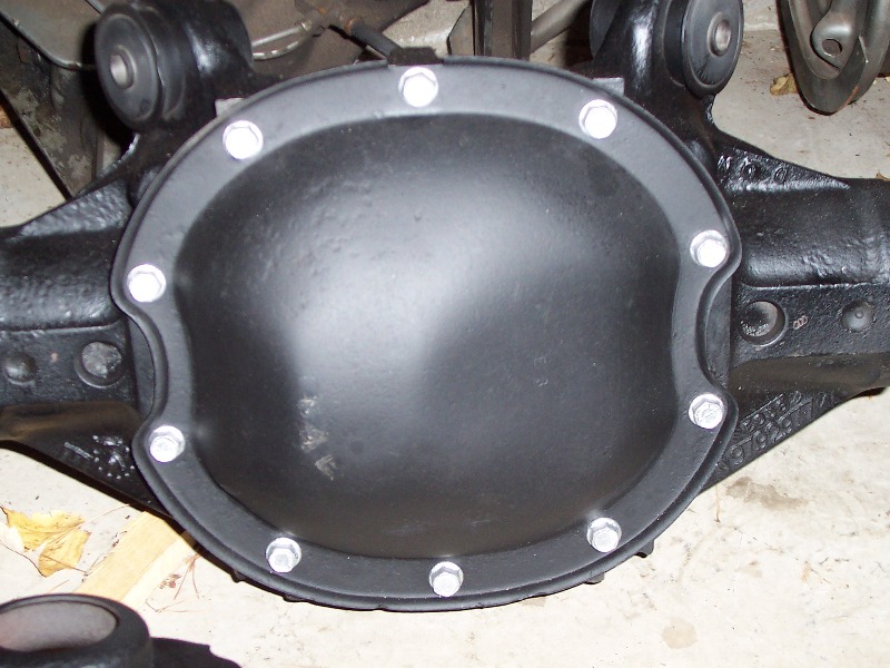

| Cover Bolt Count | 10 |

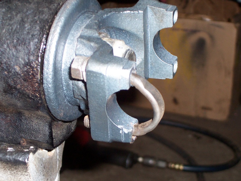

| Yoke style | U bolt & nut Universal joint retention (reference picture) |
