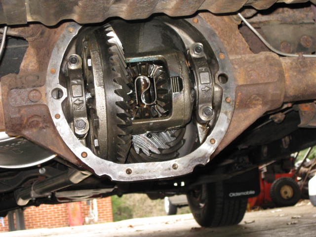

12 Bolt 'O' Type (FULL SIZE CARS 65-76)
![]() Symmetrical 12 bolt cover |
![]() U-bolts on yoke |
![]() FULL SIZE TRAC LOCK SQUARE TAB POSI |
