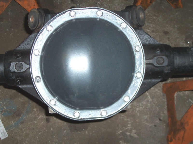

12 Bolt 'O' Type

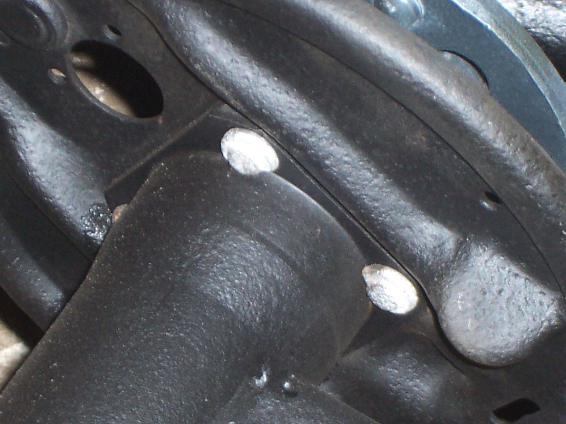

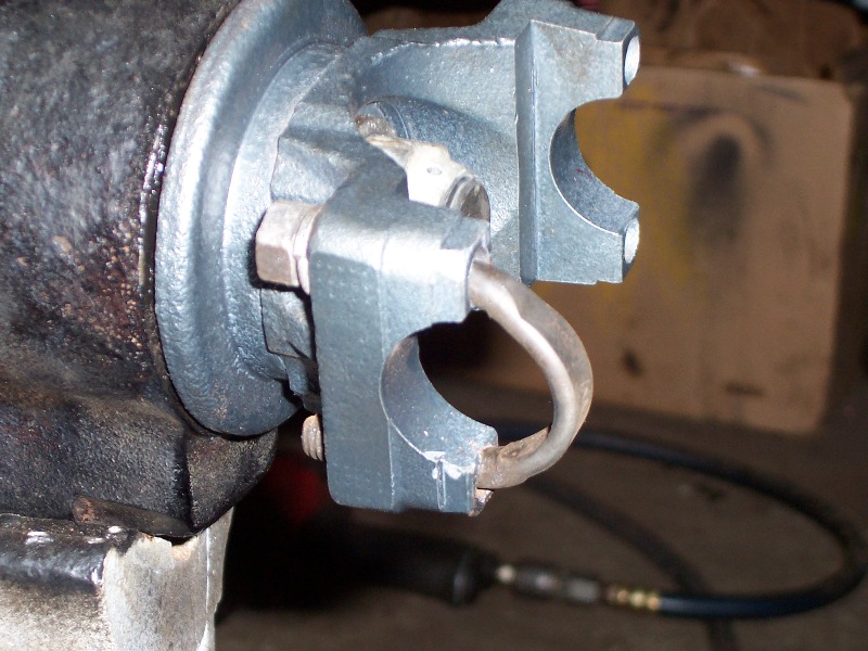

| 'O' type posi | U-bolts on yoke | Symmetrical 12 bolt cover | 1/4 cut slugs bolt in axles |

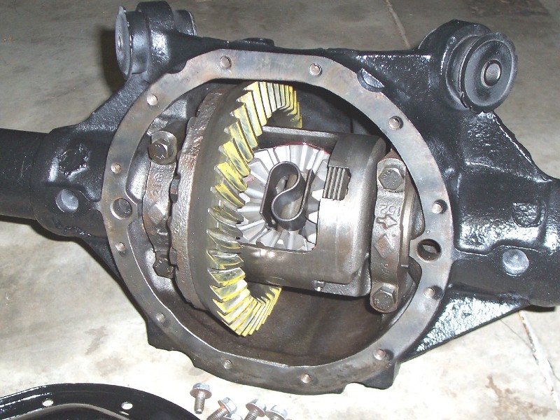

| Ring Gear Diameter | 8.4 Olds |
| Cover Bolt Count | 12 |
| Ring Gear Bolt Count | 10 |
| Ring Gear Bolt Size | 7/16 right hand thread / aftermarket gears 7/16 left hand thread |
| Axle Spline | 28 bolt in axle 60 degree spline
31 bolt in axle (SPECIAL 67-68 SUPER DUTY OPTION) 3.42 steeper ratios |

| Yoke Style | U Bolt & Nut Universal Joint retention (reference picture) |
